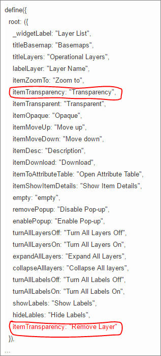

Nice work and thanks for sharing the code, however, there is a small query that might be a typo, see image below:
Yes It was an error due to cut&paste...Thank you

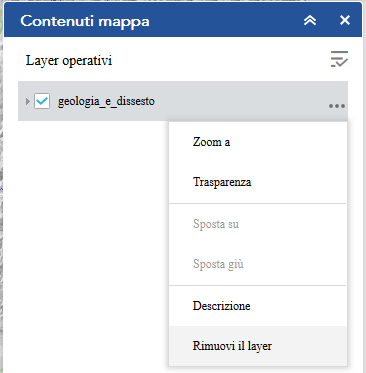

Here the images from previous post.
Options in layerlist:
ERROR
