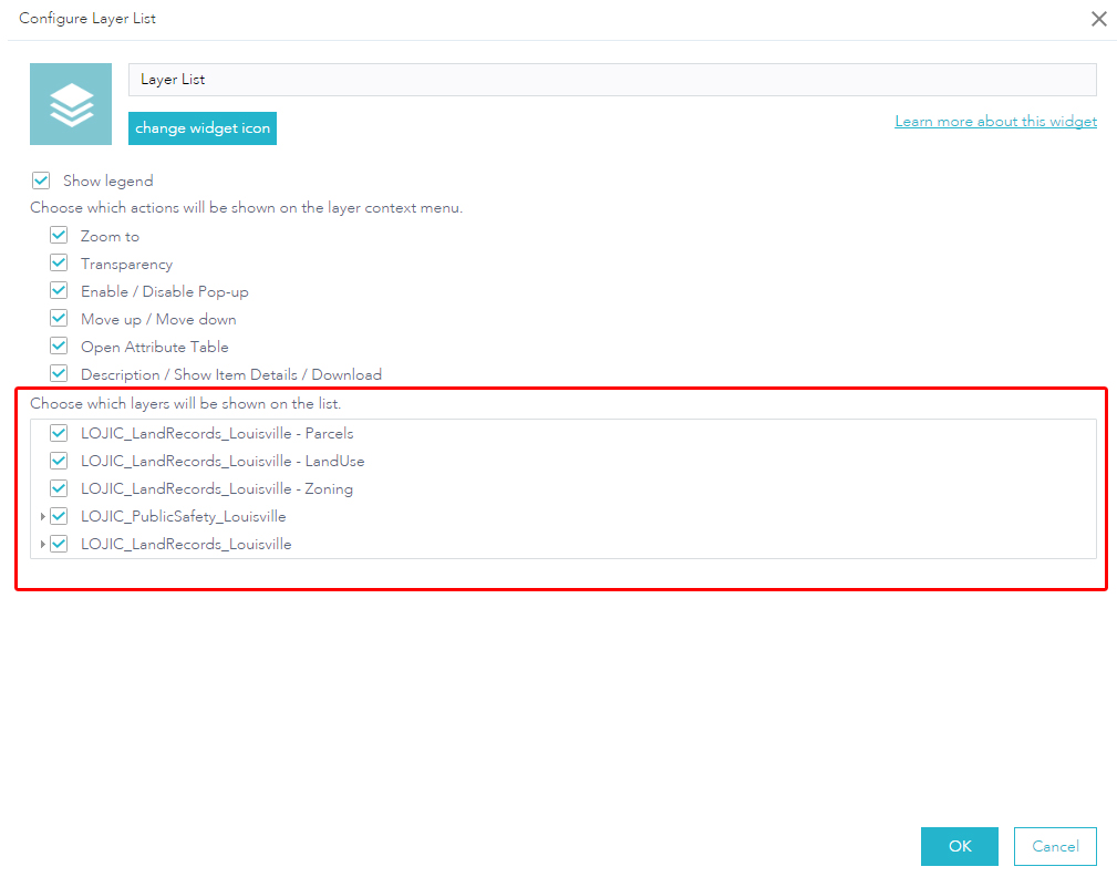

   Sure in the LayerList widgets settings you choose which layer are visible in the widgets list:
