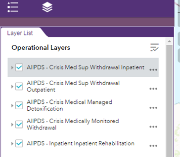

Hi,
Each week I use python to upload a mxd to AGOL. The mxd contains 30 layers or so that get uploaded into 1 hosted feature service layer. When I look at in a map on AGOL the hosted Feature Layer name appears in front of every layer in the map (in the legend and layer list). Is there way to hide the feature layer name without manually going into each layer to rename it?
My hosted feature layer is called AllPDS, notice in the image below it shows up in front of every layer.
RobertScheitlin__GISP
MVP Emeritus
Amber,
   Sure the code that need to be changed is in the jimu.js/LayerInfos.js _getLayerTitle function:
notice lines 8 -27 are commented out to prevent the adding of the service name to the layer title.

   If this is the AGOL version of WAB then the answer is no there is no way to make changes like that would using WAB Developer edition and make code changes.

   It is the WAB LayerList widget that is adding the service name so no. This is a know feature and I have posted code fixes for this in the past but you would have to be using WAB Dev Edition to apply those changes.

   You need to make the change in the [install dir]\server\apps\[app#]\jimu.js\LayerInfos.js
