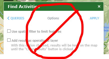

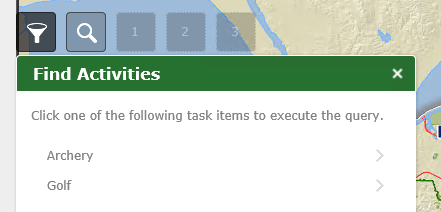

I'm trying to create a simply per-configured query using the Query widget in the Web AppBuilder Dev. Edition 1.3.
I simply want the user to choose an activity from a drop down list:
And then immediately jump to the results list:

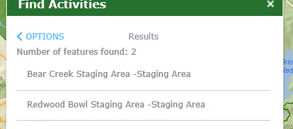

By passing the Options window:
Is this possible to do?

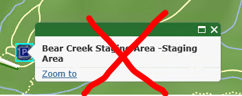

I'd also like the user to only zoom to the location they choose from the results list and not have the popup appear.
I see the popup in the config_query.json file in the application folder, but if I remove it the widget just hangs.
Thanks in advance! Meg

Meg,
  Sure both are possible with code changes, if you are using WAB Developer version:
Changes are made to this file:
[install dir]\server\apps\[app#]\widgets\Query\Widget.js
Add lines 28 and 29:
_fromQueryListToQueryParams:function(){
        //reset UI of params page
        this._resetQueryParamsPage();
        var currentAttrs = this._getCurrentAttrs();
        var layerUrl = currentAttrs.config.url;
        // this.btnResultsBack.innerHTML = '< ' + this.nls.parameters;
        var partsObj = lang.clone(currentAttrs.config.filter);
        // this.paramsDijit.url = layerUrl;
        this.paramsDijit.build(layerUrl, currentAttrs.layerInfo, partsObj);

//Automatically apply
        this._onBtnApplyClicked();
Comment out Lines 88 thru 101

          /*if(def){
            def.then(lang.hitch(this, function(){
              if(typeof this.map.infoWindow.setFeatures === 'function'){
                this.map.infoWindow.setFeatures([feature]);
              //if title is empty, popup header will disappear
              this.map.infoWindow.setTitle('<div class="query-popup-title"></div>');
              this.map.infoWindow.setContent(infoContent);
              if(typeof this.map.infoWindow.reposition === 'function'){
                this.map.infoWindow.reposition();
              this.map.infoWindow.show(centerPoint);
16 Replies

In the widget.html, I also removed the click  to return to the Options window from the Results window by commenting out these to lines:
<!--<div class="back-icon jimu-float-leading"></div>
            <div class="back-tip jimu-float-leading">${nls.parameters}</div>-->
In case that helps anyone else. Thanks again, Robert.

Hi Douglas and Robert - this did work for me in terms of removing the automatic popup that appears when a result is selected from the list.
However if I click on the map the popup appears, in addition to the one I preconfigured in the mapmanager.js. I need to remove the popup entirely from the query widget.
I'm intrigued by the panel option so hope that is possible!

Line 1216 in the Widget.js needs to be commented out then (feature.setInfoTemplate(infoTemplate);).
