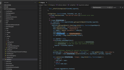

VictorTey
Hi, please take a look at FilterParameter to see if that is what you after.
Which is reference in widget.js. From memory the sql expression is build from there. Hope that helps 🙂

MarceloRosensaft
First of all, it worked!!!
Secondly, I'm far from understanding how 🤔
I found five properties with values from the widget configuration:
filterObj.filter.displaySQL
filterObj.filter.expr
filterObj.filter.parts[0].displaySQL
filterObj.filter.parts[0].expr
filterObj.filter.parts[0].valueObj.value
I played with it a little bit and found that setting the last one worked fine:
filterObj.filter.parts[0].valueObj.value = 2021;
The widget showed the right default value and, when applied, it filtered the data right.
I still have the problem of where and how to get the year value (2021) from the data layer, before the program sets the filter value. I'd appreciate a comment on the new issue or maybe I should post another thread?

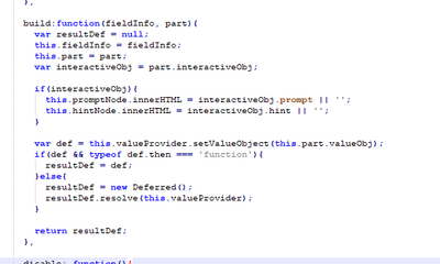

VictorTey
Hi Marcelo,
Hope i am not interpreting your question wrongly.
even after the widget have set the filter value, those values can still be changed. but you will likely have to modify and customize FilterParameter.js. The easiest way to do this is to take a copy from
WebAppBuilderForArcGIS\client\stemapp\jimu.js\dijit\FilterParameter.js and store it locally. THen update your reference to
'jimu/dijit/FilterParameters' and change it your local reference. (Note you made need to update or copy over the  references in FilterParameter as well). I hope that is helpful.
So depending if you are using _SingleFilterParameter or _filter/ValueProviderFactory you can update the default value. For example take a look at
