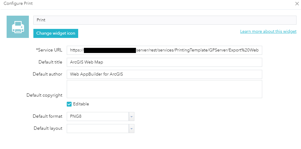

I've added the print service URL to the web application I'm putting together using Web AppBuilder:
screen capture of print configuration

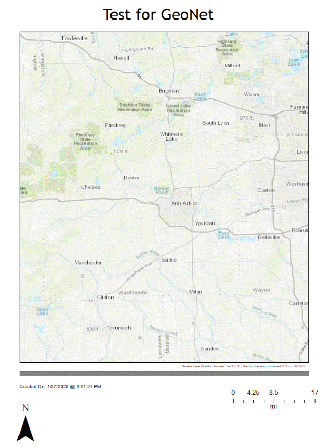

When I use the Print widget with no layers on the map (just the basemap), I'm able to successfully run my custom printing service:
successful execution of print widget

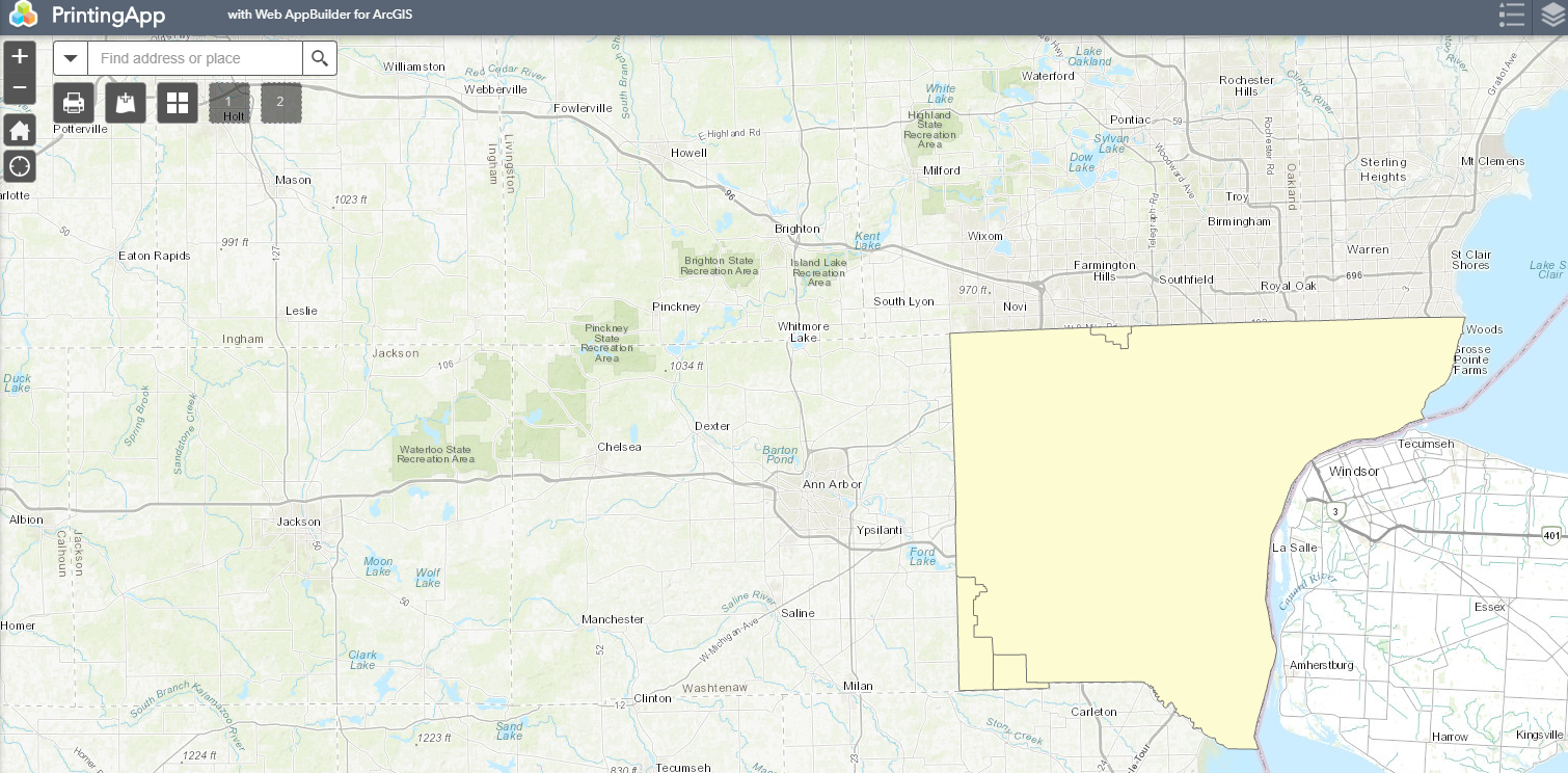

However, the problem arises when I add a layer to the map. In the below image, I've added a layer using the Add Data widget:
layer added to map viewer

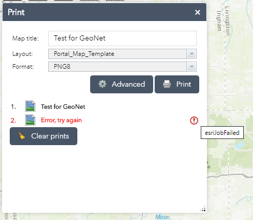

But when I try to Print using my custom template, I get the error: Error, try again. When I hover over the exclamation point, the message I get is esriJobFailed:
esriJobFailed
