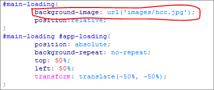

Hi Theo,
I feel it had be better to start a new thread on you question, however, you can do this by editing the configs\loading\loading.css as seen in the image below:
Baba
