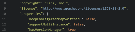

I have create a custom widget by changing the widget name for the folder and in the manifest.json

You will need to update the  "supportMultiInstance" property to "true" in the widget manifest.json file of the widget.
But please note that you may observe some issues when using both widgets together, as the Smart Editor was not designed to allow multiple instances of the widget.
