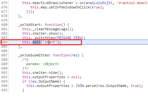

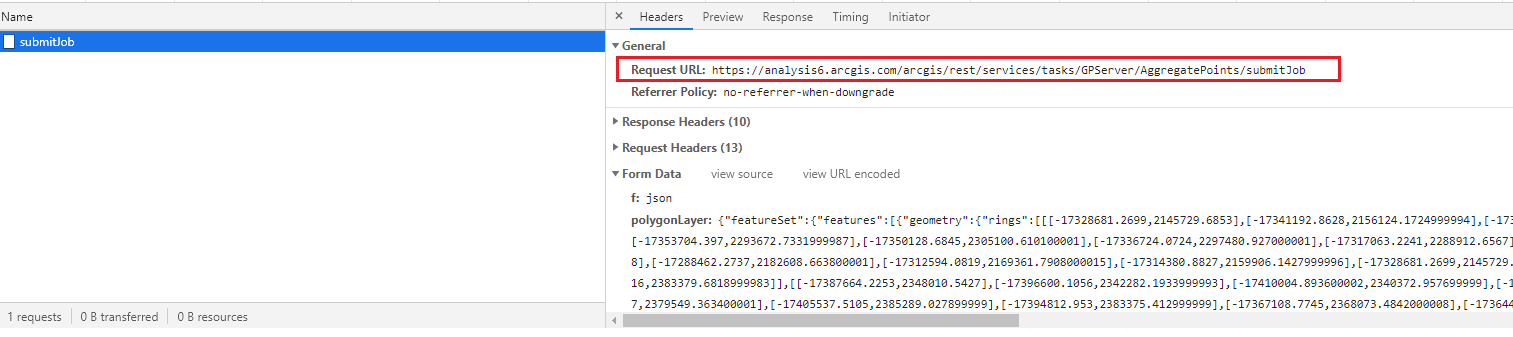

I see when geoprocessing service is called in the Network tab of the developer tools:
The last line of code that runs before the geoprocessing service is called  is this (I believe):
But I do not see how I can modify the code to pass my own parameters. For example, like this:
