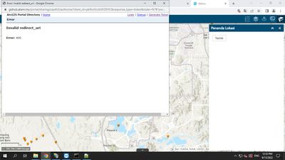

Hi Michael, I faced the same problem and I have tried your solution  to overcome the problem by changing the JS API version in env and adding the appID, unfortunately it seems not working out for some widget.  Currently, I deployed the application in ArcGIS Enterprise 10.9 with WAB 2.24. 

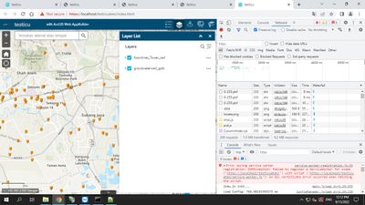

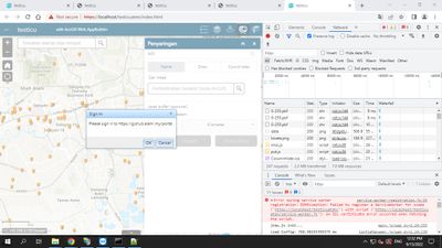

What I meant by some widget is that when i try to click on other Widget such as NearMe, Bookmarks, Legend or Layer List widgets, it shows no sign in prompt but when I clicked on  Screening Widget, the prompt sign in will pop up. When I clicked on Sign-in, it will shows Invalid Redirect.
 this is when i clicked on Layer List widget, no sign-in prompt
 but when i clicked on Screening widget, the prompt will pop up.
Does anyone have any ideas is it because of the Screening Widget or is it because of something else?
