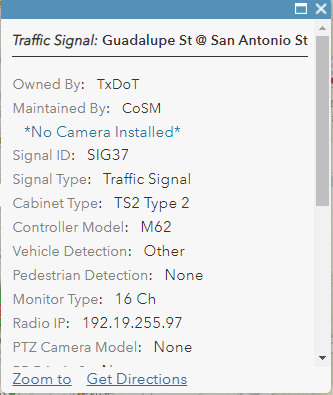

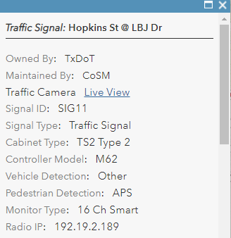

So I had a similar problem in my web map as I only wanted traffic cameras that have an IP address to show a link, and for those that do not, nothing. This was my work around.
1)Create two Arcade Expressions, one for the conditional field display, and one for a conditional link display.
Here is the conditional field display {expression/expr0}
IIF(IsEmpty($feature.CameraIP), '', "Traffic Camera")
 Here is the conditional link display named {expression/expr1}
IIF(IsEmpty($feature.CameraIP), '*No Camera Installed*', "Live View")

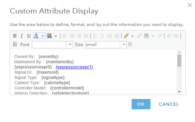

 2) I modified my Customer Attribute display where my field expression is on the left and my link expression is on the right, highlight the link expression and click on the link icon (chain link) :
3) The link window opens and I put my link expression in the "Text" parameter and my camera IP field in the "URL" parameter.

Traffic Signal with  a Camera:
Traffic Signal WITHOUT a Camera IP:
