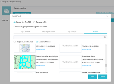

Another way to accomplish this without becoming a JS developer is to publish the geoprocessing tool as a service.
Once your tool is successfully published, you can add it to WAB via the Geoprocessing widget by searching your portal for the item, or by entering the URL to the GP service.
This method does take some careful configuring and testing, but the end result is a widget that runs the same GP tool you're used to from the desktop software, and you don't have to touch any JS to do it.
