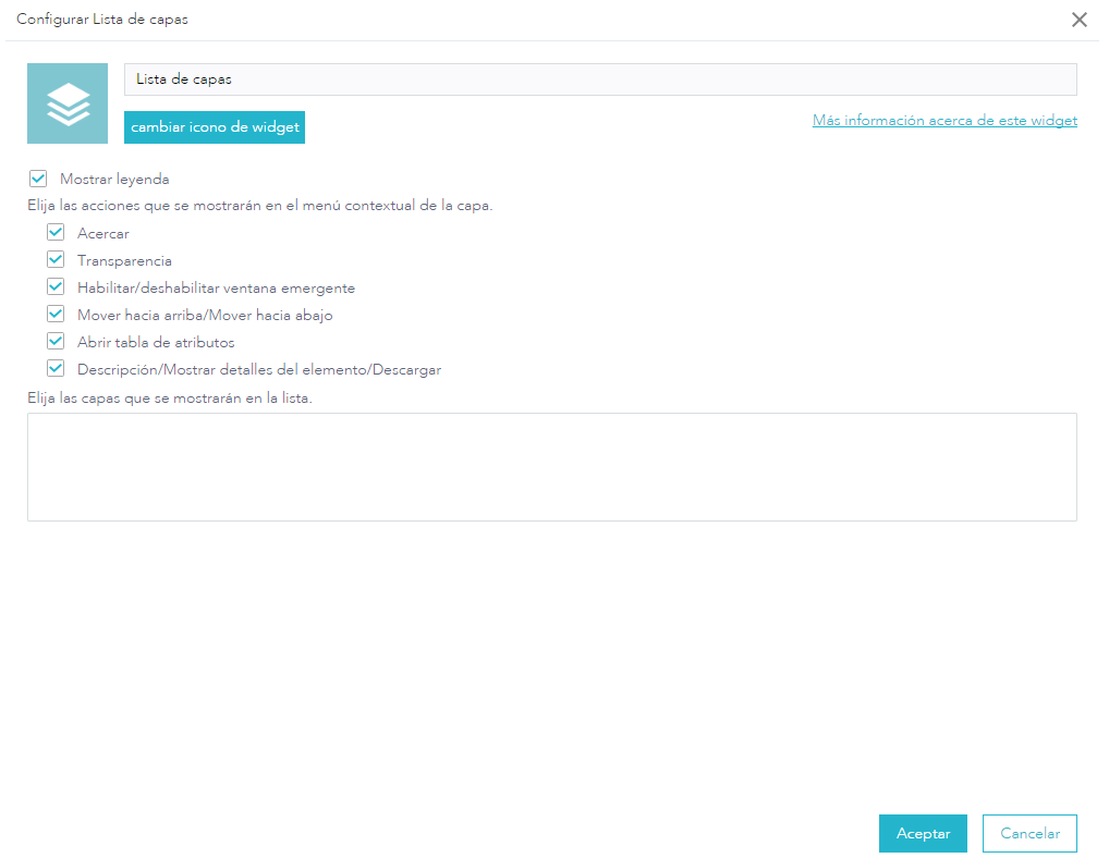

Hello,
I have 2 questions.
1.- How to cofigure the LayerList with layers from your arcgis rest service? I have tried to workaround from this but i still dont know.  For example, when i tried to add the widget in WAB, the selected layer list is empty.
Also, how the layes that i want to load at the beginning of my WAB APP come from a secured service, i dont want to let the user put the user and password each time a layer is loaded, so here comes my other question.
2.- How to use the Identity Manager window to access (using windows auth) to the whole rest service before the app loads completely.
I remember in flex there was something like this. This allows u to access the layers by default that u set them up in a config file.
If there is any guide to do this kind of things that we used to have in flex will be really appreciated.
Thanks in advice as always!

Evelyn,
1. You add the map services you want to a web map in your AGOL orgs account or you use a custom widget like the Local Layer widget.
2. To avoid the Identity manager you use a proxy:
Setting up a proxy with Web AppBuilder Developer Edition | Support Services Blog
Setting up a Proxy | Support Services Blog
GitHub - Esri/resource-proxy: Proxy files for DotNet, Java and PHP.
