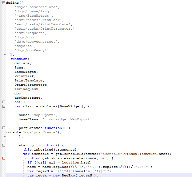

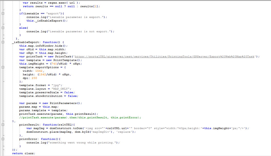

  I created new onScreen widget 'MapExport' and in widget.js file, I'm calling _isEnableExport function from startup function if the isenable parmater is "export" from the URL(https://machinename:port/webappbuilder/apps/xx/?isenable=export).
_isEnableExport  function has the code which you have shared.

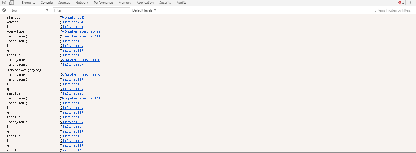

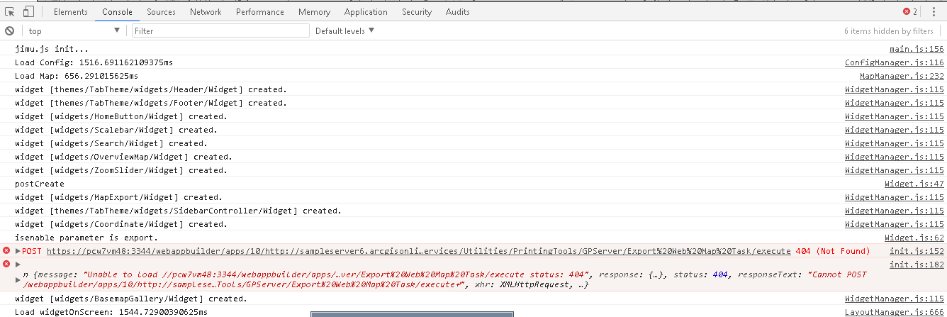

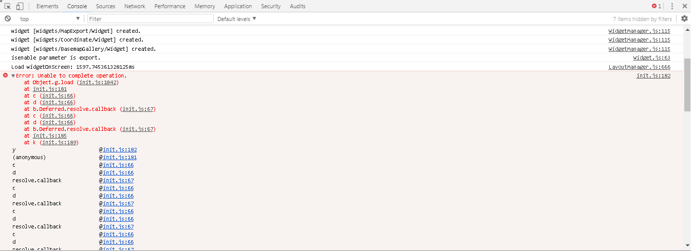

Screenshots of widget.js file of MapExport widget and Error are attached below.
Getting this error after sometime once the widget is created.
Widget.js file of MapExport widget.
widget.js file1 of MapExport Widgetwidget.js file2 of MapExport Widget

Taking the whole URL and throwing below error:
init.js:152 POST https://pcw7vm48:3344/webappbuilder/apps/10/http://sampleserver6.arcgisonline.com/arcgis/rest/servic... 404 (Not Found)
init.js:182 n {message: "Unable to load //pcw7vm48:3344/webappbuilder/apps/…ver/Export%20Web%20Map%20Task/execute status: 404", response: {…}, status: 404, responseText: "Cannot POST /webappbuilder/apps/10/http://samplese…Tools/GPServer/Export%20Web%20Map%20Task/execute↵", xhr: XMLHttpRequest, …}

  ??? Why are you putting https://pcw7vm48:3344/webappbuilder/apps/10/  in front of the url?
Naveen_KumarKairamkonda
Robert,
   I didn't give that URL anywhere in code, but it's taking like that.

   So you are telling me that you have:
var printTask = new PrintTask('http://sampleserver6.arcgisonline.com/arcgis/rest/services/Utilities/PrintingTools/GPServer/Export%2...');
and it add the other to the front by itself?
Exactly.
