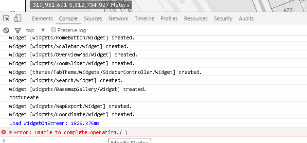

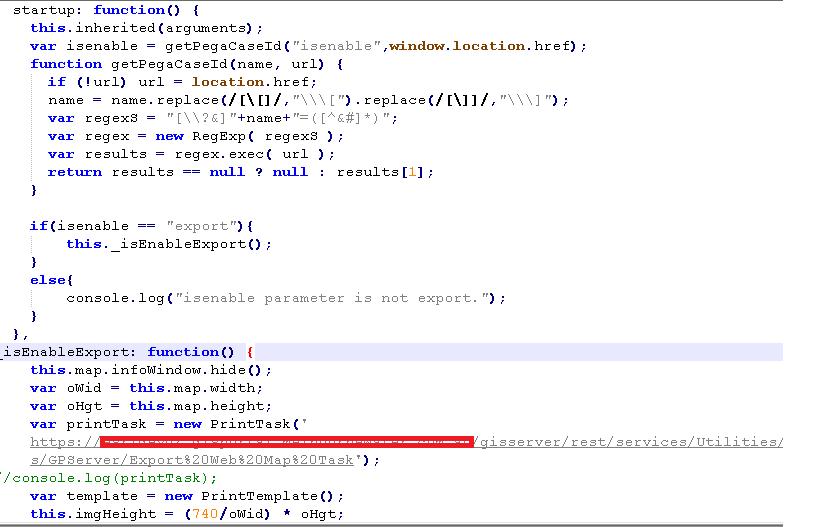

Naveen_KumarKairamkonda
Robert,
I am invoking _isEnableExport function(code that you shared) from 'startup' function of the widget if parameter in the URL satisfies to a string("export"). When it comes to printTask.execute() method in the _isEnableExport function, it's throwing error as 'unable to complete operation' in the console after a while.
You can see in below screenshots.
Error in the console:
