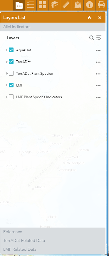

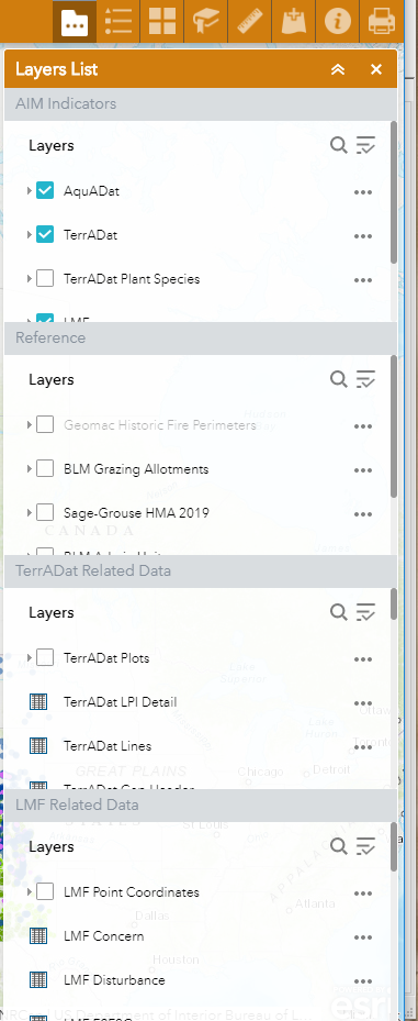

Here is how it opens:
And this is what I want:
Thanks for any suggestions!
