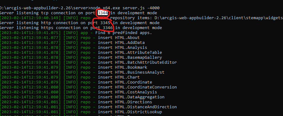

I got a new PC (windows 11), and trying to install the WAB on another port.
I followed the steps outlined on the WAB's Get Starter website  by typing under the server dir the command:
node_x64.exe server.js -4000
Then in the cmd window I noticed the screen further below.
When I tried to access the website by :
https://<mymachinename>:4000/webappbuilder I got "The site can't reached"
Even though I tried to  run WAB under port 4000 it still uses 3344. What am I doing wrong?

Ha !!! Use one dash not two      -port=4000

Try "node_64.exe server.js --port=4000"

LefterisKoumis
Thank you. That was it. The only reason why I am using the default 3344 is because I get the "The site can't reached" . I checked the port 3344 and is not used so I am lost for words why is not working.
