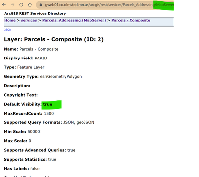

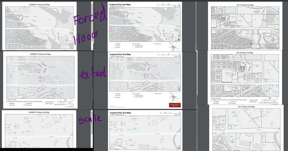

Teresa_Blader
@TanuHoque  I am having this issue, on 10.7.1. Are there new solutions these days?? Thanks!!
Esri Default Printing Tool in Print Widget in WAB works and displays parcels
Utility Printing Tool from stand alone server deployment (identical to Esri default??) distorts basemap and removes parcels.
Custom Printing Tool from Pro 2.9 layout template published in 3.0.3 with 10.7.1 also distorts basemap and removes parcels.

TanuHoque
@Teresa_Blader
I don't think the issue that you are running into is same as the original issue mentioned above. But I could be wrong.
That said, since you mentioned "Esri Default Printing Tool in Print Widget in WAB works and displays parcels", I think you problem will be resolved when you move to a new server version. Esri default print service is running on a 11.0 server.
here is the url to that service: https://utility.arcgisonline.com/arcgis/rest/services/Utilities/PrintingTools/GPServer
Teresa_Blader
@TanuHoque  The saddest news. I wish we could! Someday.... my org admins, very slow movers.
Know if there's anyway to sort of figure out if it's simply the server and not some other random thing I'm doing incorrectly? Or is that more of an Esri support question?
Teresa Blader
Olmsted County GIS
GIS Analyst - GIS Solutions
TanuHoque
hi @Teresa_Blader
Unfortunately it is hard to determine that here. Please contact Esri support. And they should be able to help...
