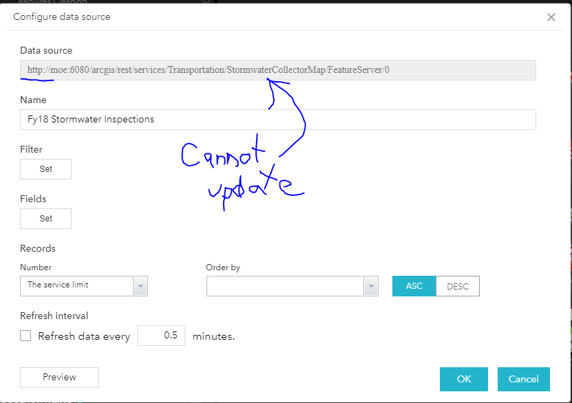

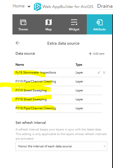

I have a dashboard themed Web App Builder product with several widgets. Recently, I updated the sources of my data services from HTTP to HTTPS urls. When I did this, some widgets updated and displayed properly, and other did not. The ones that did not update are the "Extra Data Source" filters. See screen shots 1) and 2):

Gene,
   There is no way to do this using the UI. But you can manually update the url in the apps main config.json.
