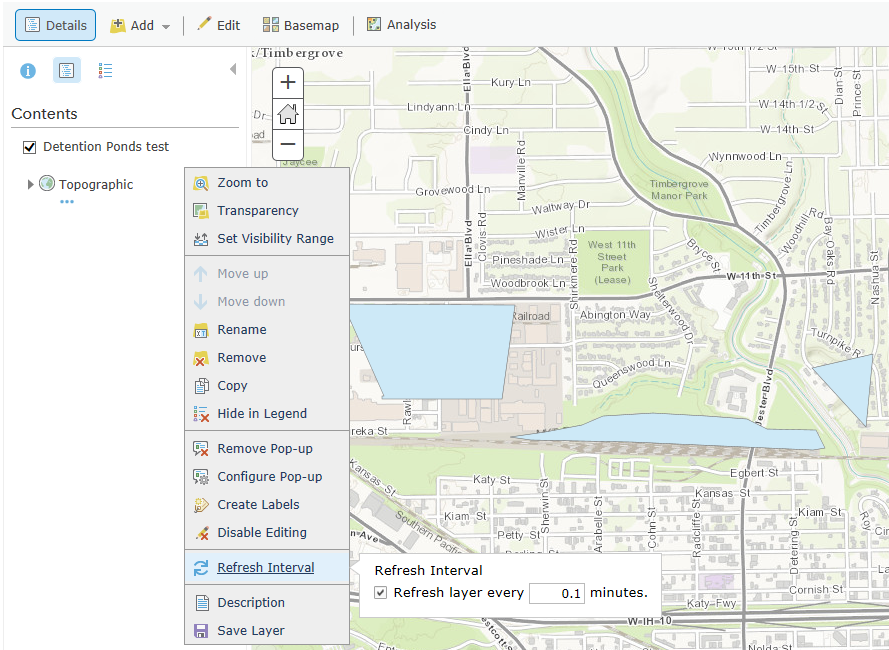

Judy,
   In your web map on AGOL/Portal you set the refresh interval for the layers you wish to refresh.
XiujuZhou
that only control data refresh in webmap. but application still not refreshed.

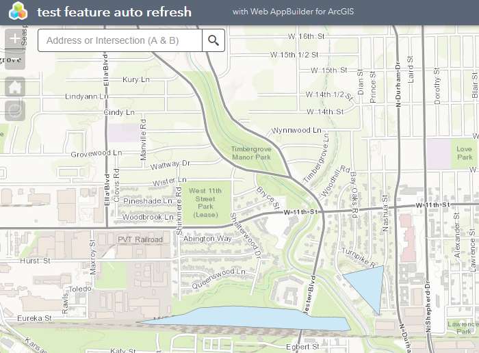

XiujuZhou
auto refresh never works for me in application side. does it ever work for you by any change?
XiujuZhou
it happens to me all the time for all my apps from web appBuilder in the past.
I setup refresh interval 0.1min, and add a new feature polygon in webmap. Then I don’t see the new polygon in web appbuilder app, unless I have to pan or zoom.
