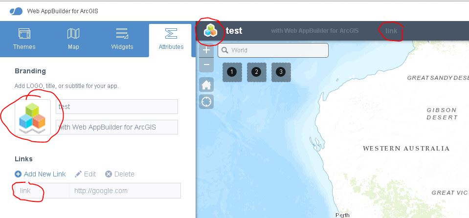

In the Attributes section of an application, you can set the app's icon. You can also add a link - this is placed to the right of the subtitle text:
How can I add a link to the icon itself, so that clicking on the three coloured blocks navigates somewhere?
