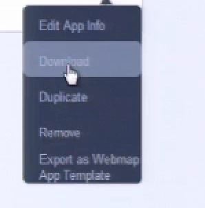

Hey Everyone,
I am having trouble understanding how my application could be exported after I'm done customizing it through the ESRI Web App Builder. I checked and in some of the videos there was an option to Export it as a web map template, which I don't have (see image). Also, I'm not able to see any of the source codes through the ESRI Web App Builder. I currently have ArcBasic. Are these features only available on the ArcStandard and higher?
Is there a work around for this? Would I have to download the app after I'm done configuring it, widgets and all, and then add it through AGOL for it to be available?

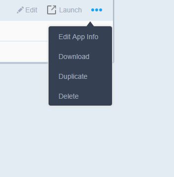

Because that was Beta 1 and it does not exist in Beta 2. Likely because this capability is being re-worked as it is be integrated into 10.3 portal.

   Once you are finished configuring your app in WAB then you click that download link this will give you a zipfile with the WAB stemApp that you can then dove tot your web server to host.

I found the video that show how to do this. In the video, the presenter was able to obtain the JSON by clicking on "Export as Webmap App Template." I guess my next question would be, do you know why I don't have this option?
