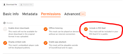

1. In SoundCloud:
  • For the track(s) of interest, got to Edit > Permissions, and  include in RSS feed
  • In your account page, go to Settings > Content and copy the RSS feed URL. I also checked the Upload Defaults Include in RSS feed option, but don't know if that is mandatory
