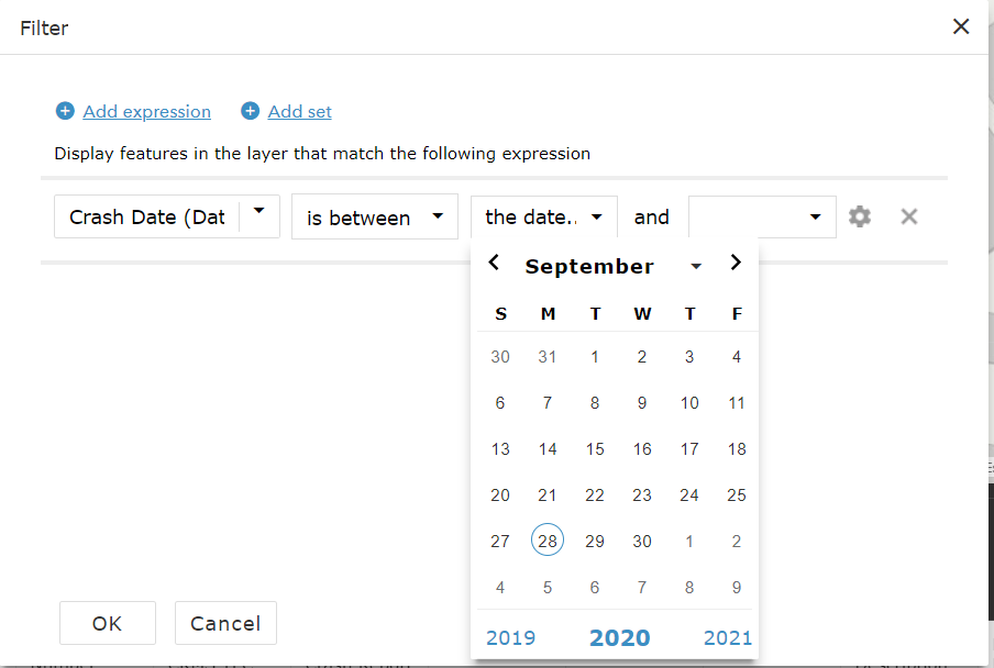

If i want to edit date field  using smart widget i will see a drop list for time along with the calendar, but when i want to filter the data based on the same date field i can filter based on the date only, is there any way to filter the data based on the date and time ? can i show the same drop list for time  similar to the smart edit widget ?

By taking a closer look at your screenshot, I just realize that this is an on-the-fly filtering function from the Attribute Table (runtime & custom filtering).
We do not support time-specific attributes filtering for custom filters (like in the Attribute Table or the Custom Filter inside a Filter widget) - see a Note in Filter widget—ArcGIS Web AppBuilder | Documentation
If you want the time options to display for users, it can be achieved by the "ask for values" option inside a Filter widget (or Query depending on your needs) and configure it in the widget setting instead:

i already configure the pop-up to show the time , but still i can't filter the data based on the date and time.
