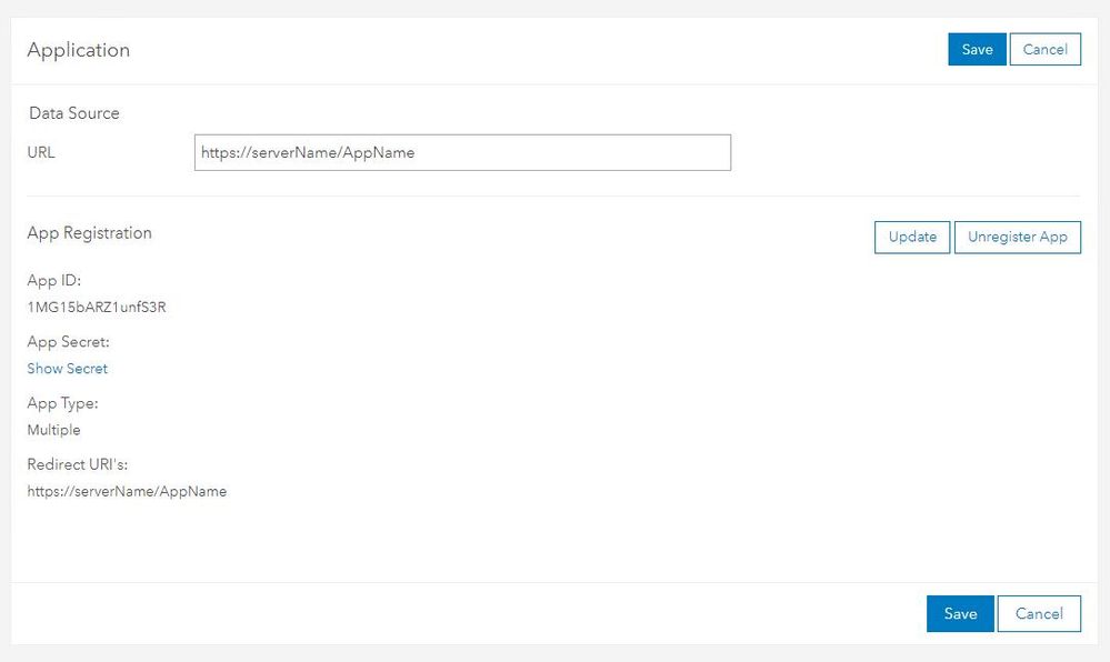

When you register your app inside of your Portal or with AGOL, it generates the App ID and that's what you're seeking. You can see the App ID in this screenshot:
The Data Source URL and the Redirect URI should be the same URL and that would be the URL to your application, installed on your server (i.e "https://someLocalAgency.gov/parcelViewer" or whatever you determine it to be)

Thank you, but I may be misunderstanding something. That app id in your screenshot is for the WAB app. Isn't there a separate id for a particular web app that I created within WAB?
e.g. what if I've created 10 app in my WAB content, how would that 1 app id distinguish between them?

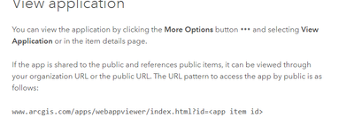

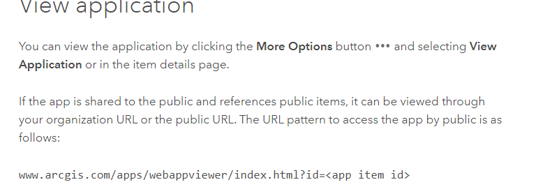

I'm trying to make public an app I created in WAB. Isn't this possible w/o hosting on my machine? This part of the documentation is what I thought was relevant:
If the app is shared to the public and references public items, it can be viewed through your organization URL or the public URL. The URL pattern to access the app by public is as follows:
www.arcgis.com/apps/webappviewer/index.html?id=<app item id>
What is this "app item id"?

I understand how to find the ID for an app built in AGOL, but not for an app built in WAB.
Here is my main concern: I created an app in WAB, and I would like to share it publicly. I was referring to this doc:
https://doc.arcgis.com/en/web-appbuilder/latest/manage-apps/view-and-edit-app.htm
