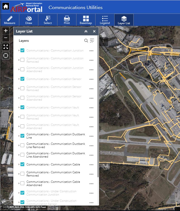

I was able to move the panel to the left side of the screen by changing right to left, but the top and bottom don't seem to change as I change the values. I should mention that I was given a custom theme to work work with ( a minor alteration of the foldable theme) is there likely to be anything in the theme files I need to change that could be overriding the top and bottom values?
  "widgetPool": {
    "panel": {
      "uri""themes/MAATheme/panels/FoldablePanel/Panel",
      "position": {
        "top"45,
        "left"55,
        "bottom"40,
        "zIndex"5,
        "relativeTo""map"
