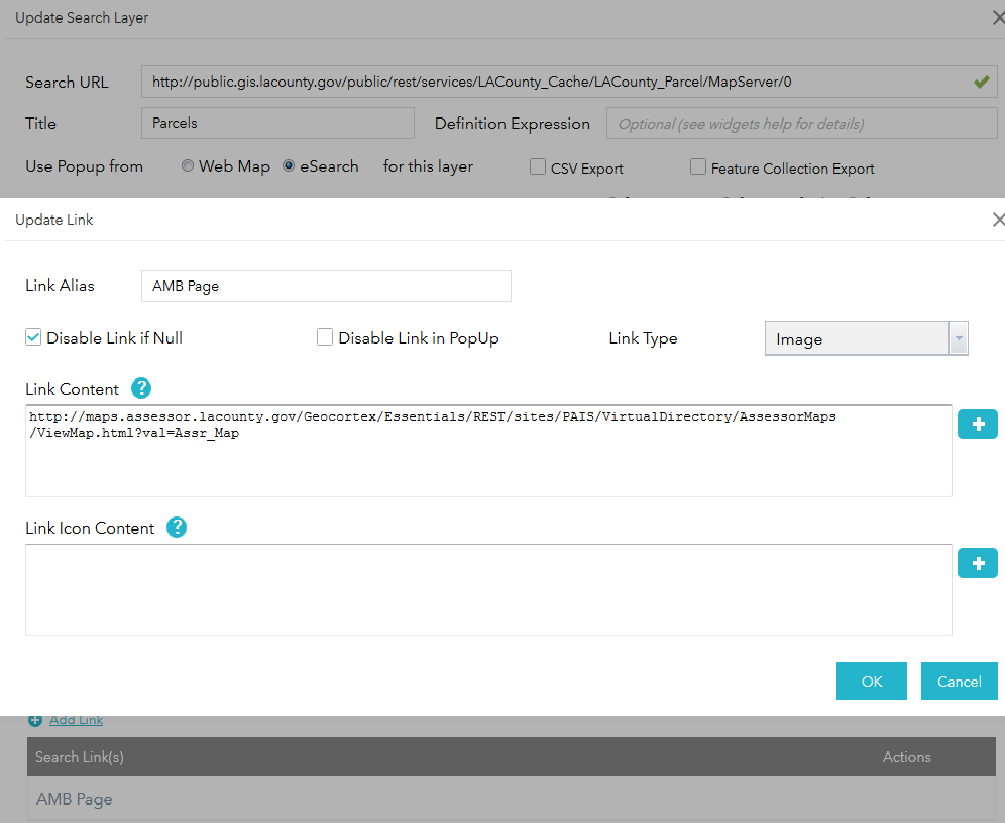

How can I accomplish the same task using the eSearch widget on Web AppBuilder Developer version? I don't know how the pass the value of the 'Assr_Map' using this:

Emilio,
  in the link content text area put
http://maps.assessor.lacounty.gov/Geocortex/Essentials/REST/sites/PAIS/VirtualDirectory/AssessorMaps...
and then click the plus button to the right of the text area and choose the Assr_Map field
and change the link type to text instead of image.
RobertScheitlin__GISP
MVP Emeritus
Emilio,
EmilioSolano
Awesome! Problem solved. Thank you very much.
Emilio
