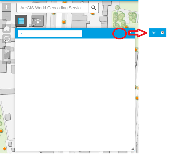

Hi Team,
For On Screen widgets in ESRI Web AppBuilder, minimize/maximize buttons are visible only in mobiles but not in iPad / Tabs. Could someone please tell me how can we add.
Robert Scheitlin, GISP‌, Could you please give me some ideas how can we do this. Thanks in advance!
Thanks & Regards,
Vara Prasad

Vara,
    The apps mobile break point is set to a width of 600 in the main.js that is what determines if the app goes into mobile mode or not and because most iPads and tablet have a screen width of greater than 600 it will not show the buttons. To fix this in the main.js change this:

Vara_PrasadM_S
Thanks a lot Robert Scheitlin, GISP‌. It worked.
