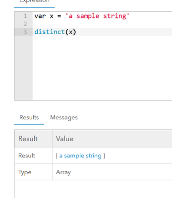

The expression you have written here is in the dashboard formatting profile of Arcade, which cannot do what you're trying to accomplish. You're telling it to return the distinct values of the provider name of a single datapoint. The function treats this as an array with a single item in it:
Consider using a Data Expression, similar to this example.
