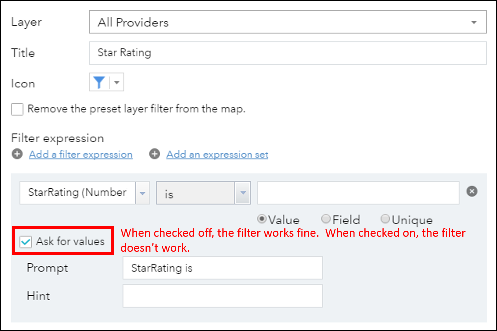

I'm testing the new filter widget available in Web AppBuilder that came with Portal for ArcGIS 10.5.  When I create a filter with preset values entered, everything works fine.  However, when I check the box to "Ask for values," the filter won't load.
Ask for Values checkbox in filter configuration window
 In the filter tab, I can see the filter name with a load icon next to it.  However, it won't finish loading and I can't open/use the filter.

I finally figured out what was going on.  The service I was using in the filter was being pulled in from an ArcGIS Server on my Production machine while the web app I was using was running on my Development machine.  The service is secured so only certain people could access it.  Even though I have permission to view the service and can view it in the web app, I think the filter tool is using the Development machine's credentials when it passes a request to the ArcGIS Server.  Since the Development machine is not permitted to view the file, the Production server was denying access and the web app was getting hung up.  When I copied the data to my Development ArcGIS Server and ran the filter using those files, everything worked as expected.
