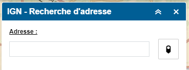

I create a widget to find an adress with french ign service geocoder.
It help to write a correct adress or, from a click, it give the adress.

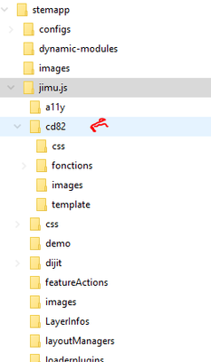

Yes. I put all basics functions in jimu.js in a personnal folder. I must copy it every time I update wab :

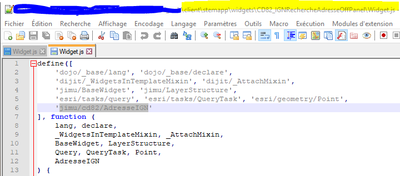

Then I call it in the specifics widget like this :
GuillaumeArnaud_1-1637244862017.pngGuillaumeArnaud_1-1637244862017.pngGuillaumeArnaud_2-1637244916426.pngGuillaumeArnaud_2-1637244916426.png

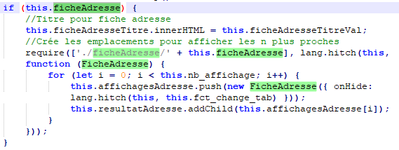

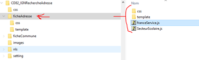

For the specific content of the feature, I put a widget in a subfolder to display the information :
I specify it in config and I load it with require in widget :

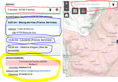

You can see the app here : https://lacarto.ledepartement82.fr/FranceServices/
Search (right) is the first widget.
SidePanel is the second widget.
Red is in jimu.js/personnalfolder.
Blue is in the subfolder to display the information.
Yellow is also in another subfolder but works with attributes.
