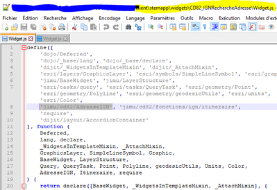

Hi,
Yes. I put all basics functions in jimu.js in a personnal folder. I must copy it every time I update wab :
Then I call it in the specifics widget like this :
For the specific content of the feature, I put a widget in a subfolder to display the information :
I specify it in config and I load it with require in widget :
You can see the app here : https://lacarto.ledepartement82.fr/FranceServices/
Search (right) is the first widget.
SidePanel is the second widget.
Red is in jimu.js/personnalfolder.
Blue is in the subfolder to display the information.
Yellow is also in another subfolder but works with attributes.

Hi,
Great.
Guillaume.
