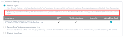

Thanks @JayantaPoddar. When reviewing that documentation it seems like it should provide my solution. However when I attempt to configure the 'download' section of the screening widget I see this warning. Can you confirm if you are able to successfully download SHP through this widget in ArcGIS Enterprise?
MarcoDestavola
I tried to follow the same steps, I can download CSV and GDB feature class, however but no SHP.
