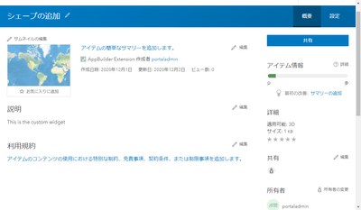

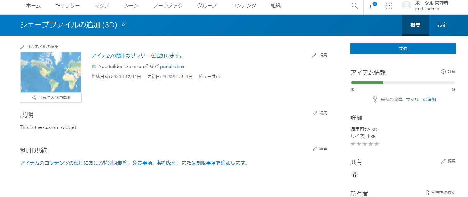

②Adding items from ArcGIS Enterprise
Adding custom widgets in the application extension (AppBuilder) in ArcGIS Enterprise 10.8.1
The title: シェープファイルの追加 (3D)
③Creating a WebAppBuilder from ArcGIS Enterprise.
Add a custom widget added in ②
An error occurs that the app will not start.
Q: Shouldn't the names ① and ② be the same?
Is there a limitation in the item name or a known bug that prevents the application from launching normally when the item name registered to Portal and the _widgetLabel of nls/en/string.js are the same?

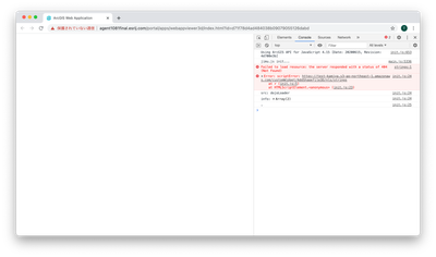

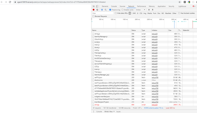

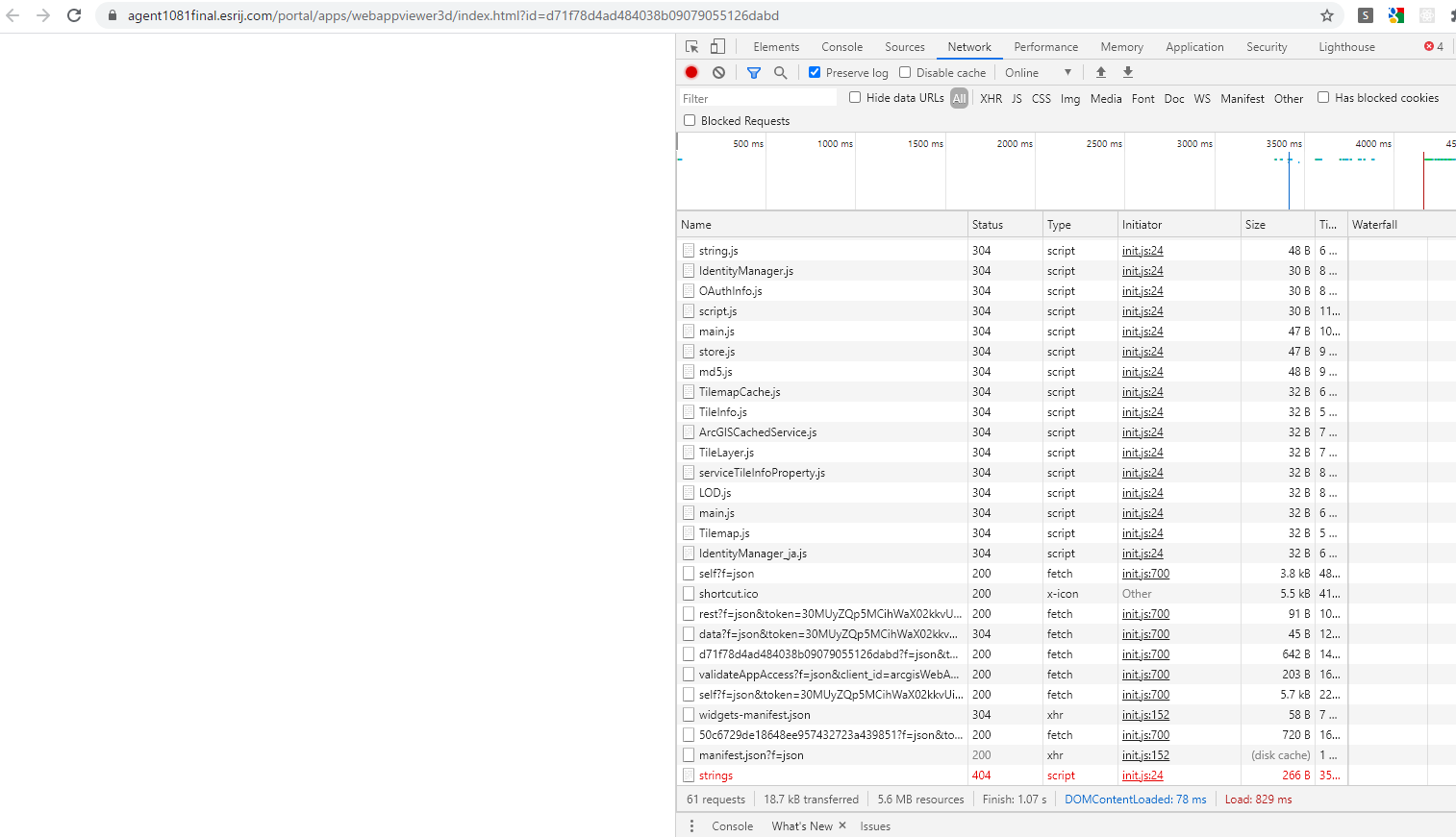

Hi,  there isn't an issue. I do it all the time. The title of the item will take precedence.  However you are getting a 404 and it is erroring out on string and not string.js. if you take the url that 404 and paste it in a new tab, i can guarantee it is not resolving.  I am guessing somewhere in your code or a dependency library is calling out to string something like
"dojo/i18n!../nls/strings",
TakahiroKAMIYA
Thank you for the information.
It is an error, but you are experiencing the above error.
VictorTey
Hi did you take the code from the add data widget?  cause if you did I don't think it is going to work. You will need to use wab developer. The problem is the path resolution for the string.js. Maybe you can
try replacing
"dojo/i18n!../nls/strings", to the full path of your string.js. e.g https://xxx.xxx.xxx/strings.js

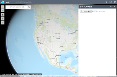

Add an item title with a different name シェープの追加
In that case the app will launch normally.
Would it be a matter of custom widget settings, etc.?
