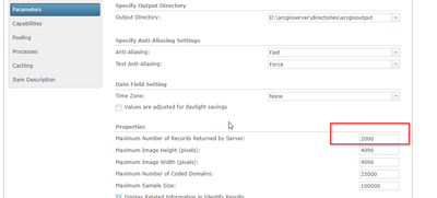

VictorTey
Hi can you test if you can access arcgis manager and see if you can modify the value in Parameters and change the max record from 2000 to 3000.

VictorTey

Thanks for the reply Victor.
I'm not sure I can access the ArcGIS Manager from my position but that seems to be the reason why it is only allowing me to export 2000 records instead of all 125557 of them.
The next question I have is is there a limit to how high this value can be set? For instance could I set it all the way to 12557
