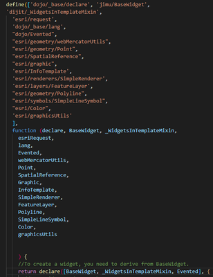

Have you added the
'dojo/Evented' module to your define array and the declare array like the drawTool.js file has?
this.emit comes from that module.
LefterisKoumis
THanks Robert. The Evented module is present and is still not working.
RobertScheitlin__GISP
MVP Emeritus
@LefterisKoumis
and you are sure Evented is part of your declare array too?
return declare([BaseWidget, _WidgetsInTemplateMixin, Evented], {
LefterisKoumis
Positive.
