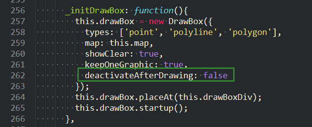

When you click drawtool on Draw widget, the drawToolBar will be activated, then you can draw a geometry on map. After you finish drawing, darwToolBar will be deactivated. This is by design.
If you want to draw graphics continuously, you need to add the following line of code in Query/Widget.js.
