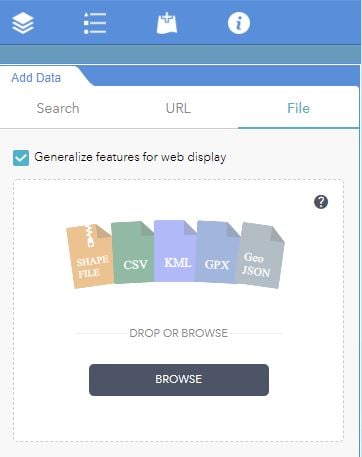

Hey folks, I'm looking to see if anyone has had success disabling the "generalize features for web display" functionality in the add data widget under the file tab. In general, this is great for rapid web display but specifically for our project we had it there so non-mappers could do QA/QC on some map stuff and they're seeing errors that aren't there because their file they upload is being generalized. At this moment we just have told folks but I'd like to remove this option for this application in particular. Thanks in advance! - Christina
Screenshot of web appbuilder built map application add data widget with the generalize features for web display toggled on

Christina,
  There is no setting to disable that option but if you are using WAB Dev edition then I can provide the code changes to make that happen.

Add this css rule to the widgets style.css:
.generalize-options {
  display: none;
Make this edit to the widgets search\templates\AddFromFilePane.html (Line 6 set to false):
<div class="secondary-pane add-file-pane">
  <div class="generalize-options">
    <div data-dojo-type="jimu/dijit/CheckBox"
      data-dojo-attach-point="generalizeCheckBox"
      data-dojo-props="checked:false">
    </div>
  </div>
