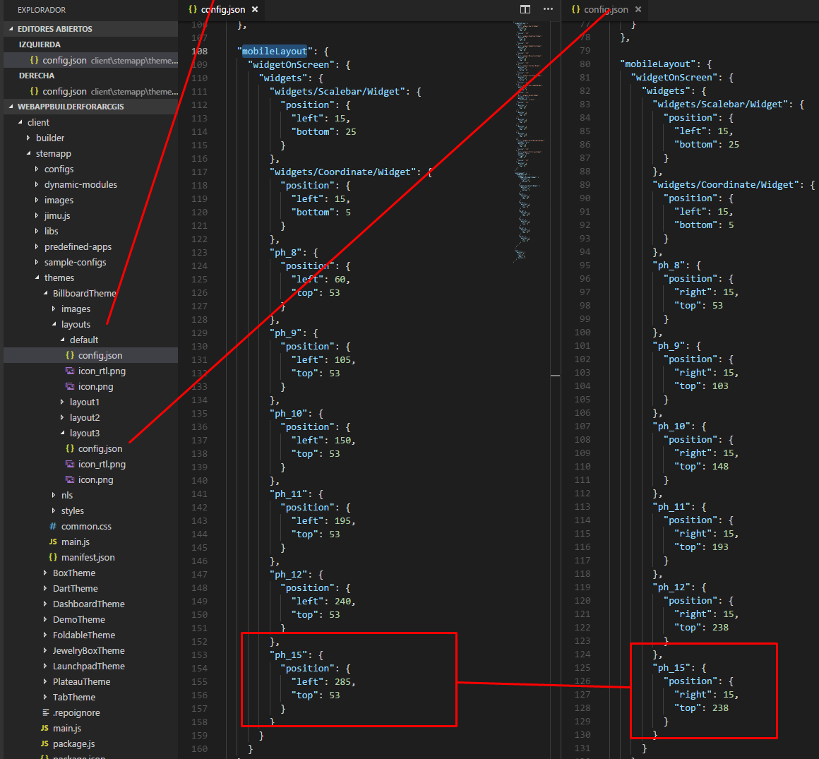

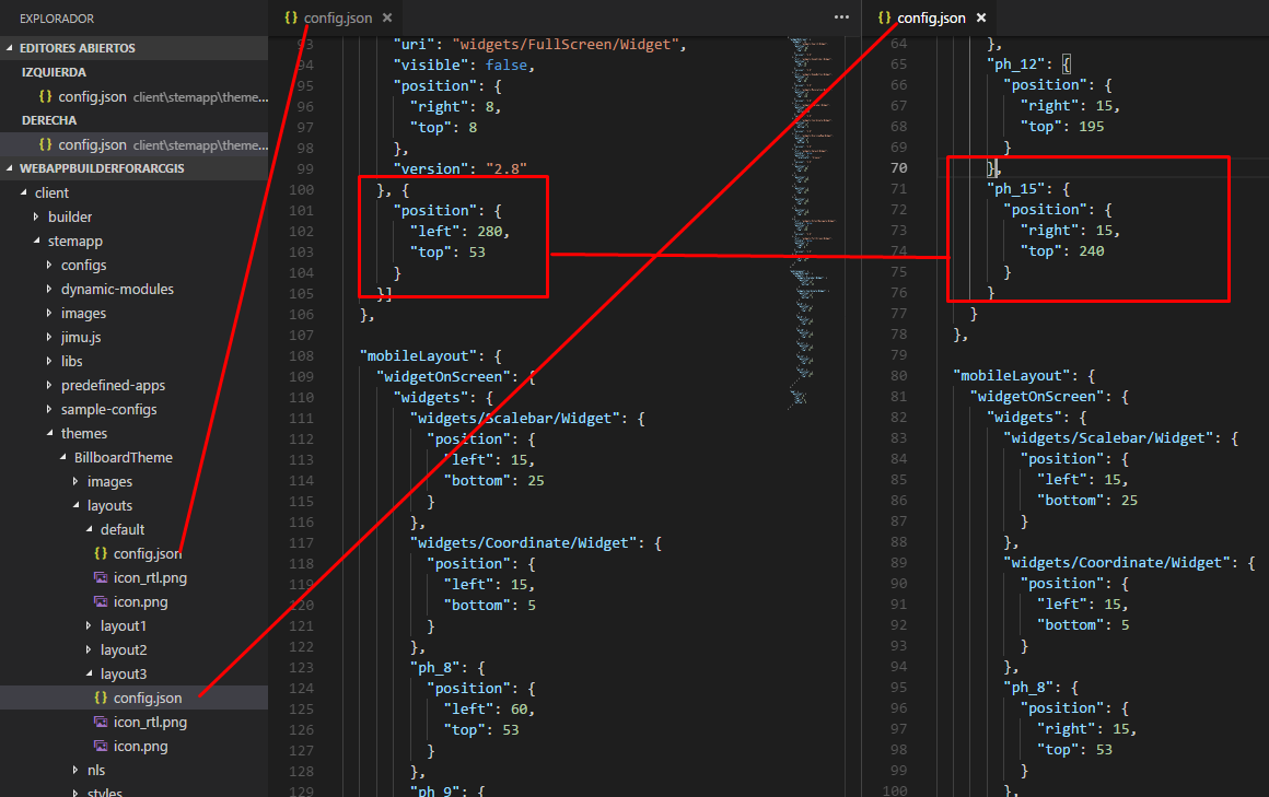

The changes to add a position of a widget are not displayed.
1. Add a position in layout (default) and layout 3 in widgetOnScreen
2. Also add in mobileLayout
** I do not see any change. What am I doing wrong?
Atte: H. Daniel Ramos Mendoza (HDRamosMendoza)

William,
   When changing those files you will have to create a new app before you see your additions.
