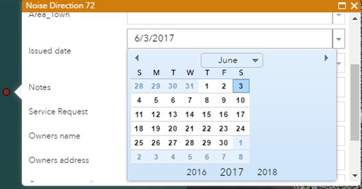

When creating a new feature using a webapp editing widget the date format is coming up incorrect (month, date, year) which is quite a problem for us within New Zealand.  How do I fix this?

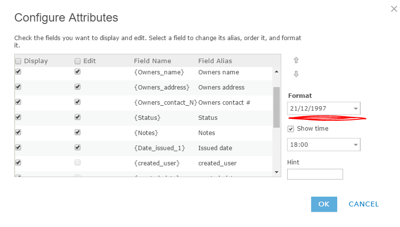

I have customised the date format within the web map and I can confirm that day,month,year has been chosen (see below picture) and this comes through for the pop-up BUT it the editor within the webapp still defaults to m/d/y.
The original data was created using d/m/y type and our sever also defaults to this format.
The below should be 3/6/2017.
