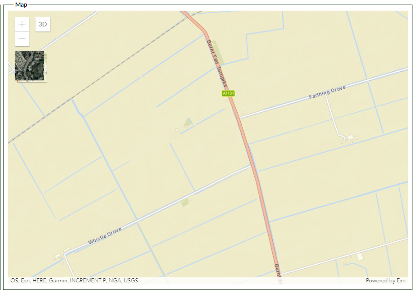

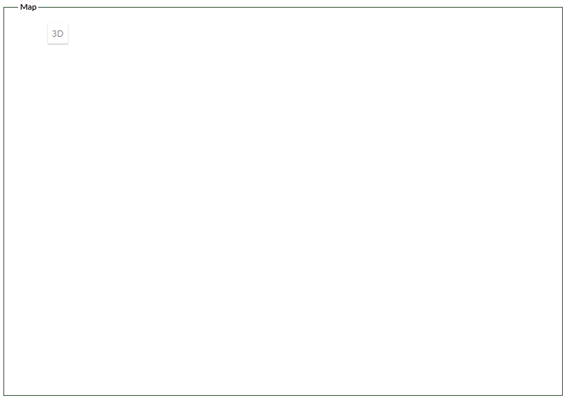

bobypan8089
I have the same problem.
When I am clear the cache, that I am not able to load the map for the first time. I have to refresh the page after the map will load.
Here, I have attached the snapshot of the map1. Map is not loaded1. Map is not loaded2. Map is loaded after refreshing the page2. Map is loaded after refreshing the page
