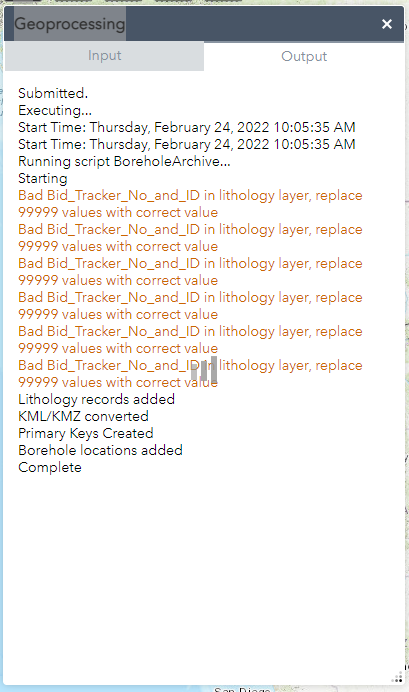

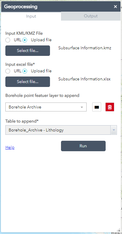

What it looks like in WAB pre run:
After running:
