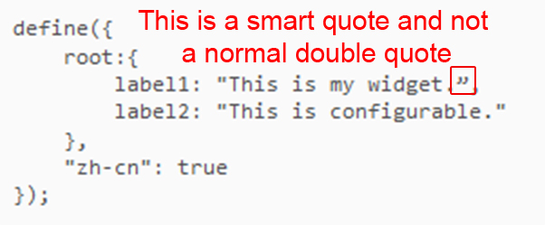

   Thanks for fixing the missing comma in the documentation. There still remains the issue of the smart double quote vs a standard double quote that is causing an issue for those who just copy the code from the website.

Robert,
The smart double quote has been corrected on the developers site. Thanks!
