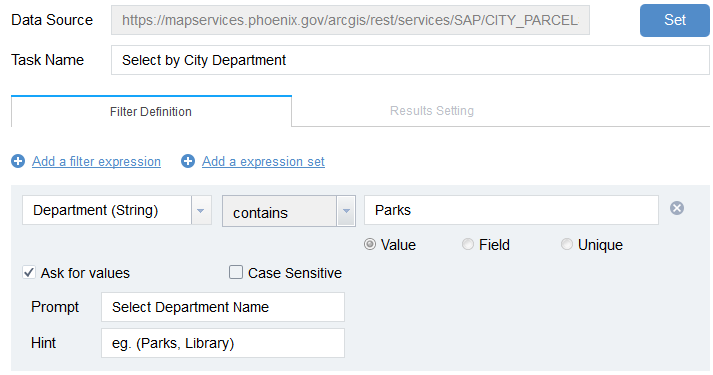

So I configured my WebMap and the use my locally installed Web Appbuilder to configure an application. I configure the Query widget as such:

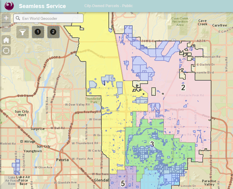

and my basemap look like this based on the Webmap which is the World Streets with a City of Phoenix focus:

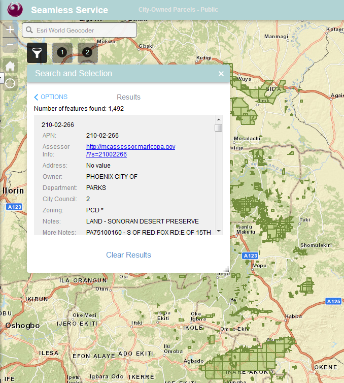

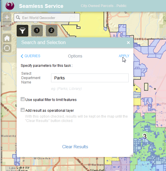

When I test the query:
I end up with a basemap in Nigeria Africa !!!
Bwaaaaahahaha!  Gotta Love This Stuff! Let me guess, a projection issue? Where?
VenusScott
As it turns out, WAB has an issue when the queried results are > 1k records! If it was resolved in the 1.x release version, they broke it again
ESRI support has determined that the "projection on the fly", when used in WAB builder, is the problem where my queried records end up in Africa. ESRI is going to provide me with a BUG number to reflect this problem.
