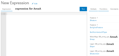

yockee
Hi @AlixVezina ,
I tried it but can not find the related Feature Service that I want to count from. Here I am trying to set the Smart Form for feature service AreaA to count the underlying feature service (or map service) PointB. There are no attributes for PointB that are listed. They are not detected. Why ?
AlixVezina
There's an example in this blog: Go Beyond the Smart Editor using Smart Forms
The first example for Calculate statistics is to count features.
Here's the sample code you can modify:
// Define the source layer to intersect (replace layer name "Addresses" below)
var sourceLayer = FeatureSetByName($map, "Addresses")
// Count the number of intersecting features from the source layer
var countFeatures = Count(Intersects(sourceLayer,$feature))
// Return the value (number)
return countFeatures
