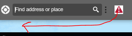

Hello,
I am looking for the location of the .json or .css (or whatever the file is) to change the location of a custom widget with the Dart Theme? I do not like the location and want it UNDER the 'Search' widget.
This widget is in the 'Dart Controller' box of the Dart Theme. Do I need to modify a widget config file AND the Theme config file??
Any help would be wonderful. Thanks!

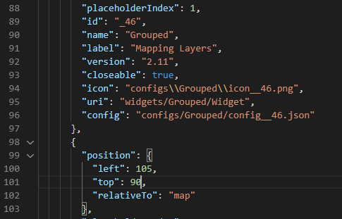

You should be able to accomplish this by changing only the config.json file in your app (Install location:\Webapp Builder\WebAppBuilderForArcGIS\server\apps\"app#"\config.json.
Find your widget in the config.json file and then change the "left" and "top" properties for its position.Save and reload
