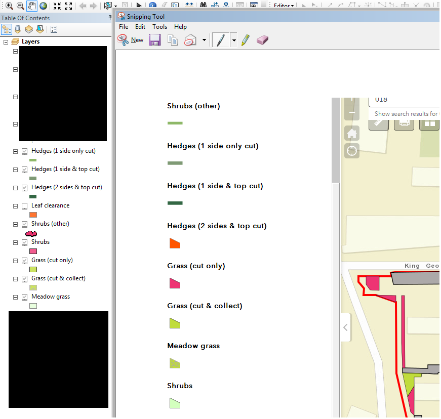

Anyway, from my MXD I click share as service. This uploads all the layers and their individual symbologies to 'My Content' on my ArcGIS Online account. Integrating this into a Web AppBuilder is relatively simple. The end result is an online map that looks like my original MXD. Great.
However, if I decide to change the order of layers in the MXD's table of contents, then share the map as a service (overwriting the existing one), the legend glitches out on the online map (the Web AppBuilder). Looking down the legend on the online map, the legend is fine up until the first layer where the order has changed.
See below (unaffected layers blacked out. the left shows ArcMap 10.4, and the order I intended for the layers. On the right is the resulting legend in the web map. All jumbled!) nb. this incorrect symbology was not reflected in the map itself, just the legend.

Hi Theo,
This behavior is expected and by design. When you first publish your map doc as a map service, each layer is given a unique ID. For example, let's say you have a map with 3 layers: A, B, and C. When you publish it as a map service, (going from bottom to top in the TOC) layer A is given layer ID 0, B is given layer ID 1, and C is given layer ID 2. When you create your app in Web AppBuilder and start to configure widgets, the widgets will read and work with the layer IDs assigned in the map service.
If you change the order of your layers in the map doc, then re-publish it, the layer IDs of each layer will also change. So when you re-open the web map in the Web AppBuilder app (built on the previous web map) - the widgets may not display the correct information. You will have to create a new app, which would reference the new layer IDs.
In ArcMap 10.3, we introduced a feature in the Data Frame properties General tab. There is a checkbox "Allow assignment of unique numeric IDs for map service publishing" that will address this "issue". If you check this checkbox BEFORE you publish the map as a map service the first time, then the workflow you describe will be supported.

Derek Law‌ I tried your suggestion of ticking that check box then publishing the service. However this only made it worse!
All the legend items in the webmap are wrong now. All over the place!
EDIT: phew, luckily unchecking the box, saving the MXD and re-publishing the map restored the orignal legend/symbology/layer order.
Seems like this is a bit of a broken process.

Hi Theo,
You need to check this checkbox BEFORE you publish the map as a map service the first time. Then you have to recreate the web app and re-configure all of your widgets in Web AppBuilder.
Then, if you decide to change the layer order in the map, add new layers, etc. and re-publish the map service - this will not affect how the data layers appear in the web app.
Since you did not have this property checked BEFORE you created your web app originally, it won't work.
