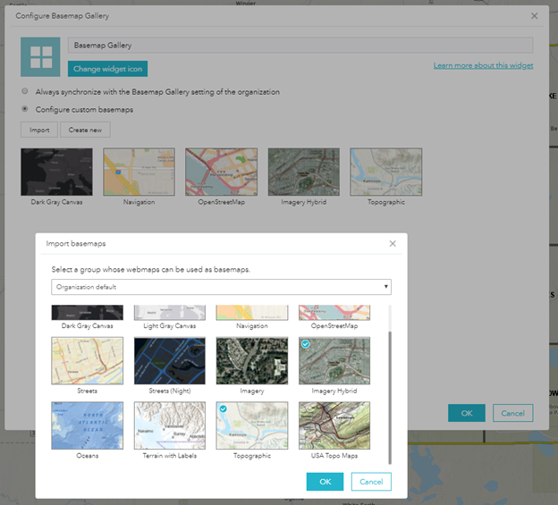

  • The web map was shared to create a Web AppBuilder app, and the Basemap Gallery widget was configured with the option to "Configure custom basemaps".
  • Five of the web maps (basemaps) were imported from the "Organization default", and the Basemap Gallery widget configuration was saved.

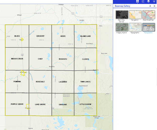

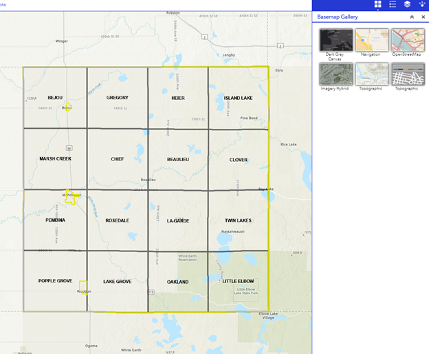

  • ISSUE: When opening the Basemap Gallery widget, six basemap options appear. In the screenshot below, none of the options have been chosen yet. The map is still displaying the basemap setup in the web map.

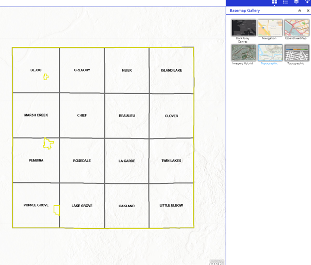

  • ISSUE: When the Topographic basemap option is selected, the map displays what appears to be the basemaps hillshade layer but not the reference layer.
  • ISSUE: When the second Topographic options is selected (the one I do not believe should be there because it is displaying the thumbnail for the web map being used in this app), the map displays what appears to be the correct basemap.
I have configured this widget many times before, and have observed this behavior only recently, and in one other Web AppBuilder app that I've configured. Below is the Basemap Gallery widget configuration used.
