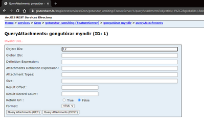

Hi @TórshavnarKommuna ,
Thanks for sharing the web app & the feature service. When trying to query attachments for the said layer it returns Invalid URL. Also when I try to add the layer to the map it is unable to add.
You might want to check if the query attachments is able to return results. This will help to troubleshoot if the features contains attachments.
Once you have the results I think it should ideally be displaying in the web app as well.

TórshavnarKommuna
Thanks for the tip @ManishPatel
I have published the service using ArcGIS Pro and then it started it to work. But this was just a test service I was trying to setup, after running into problems with another services we have published.
