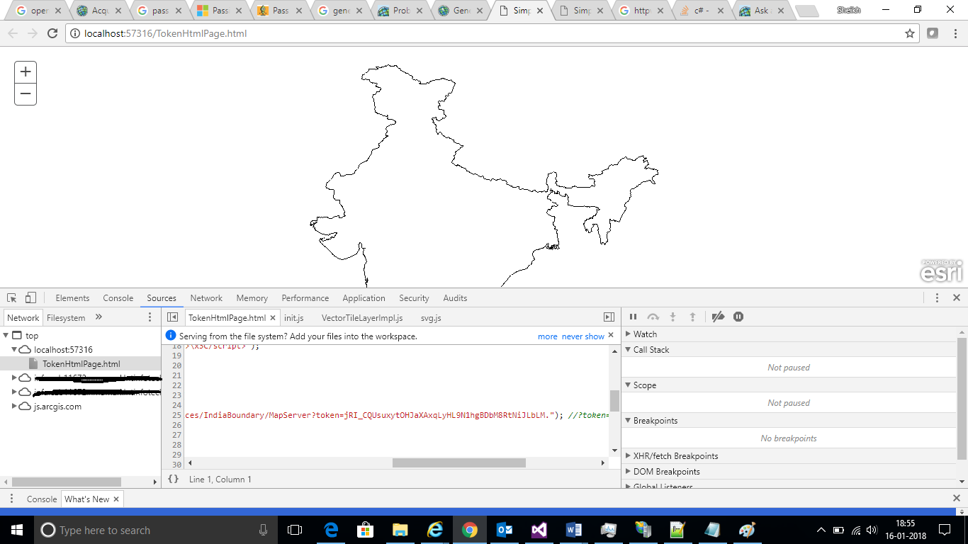

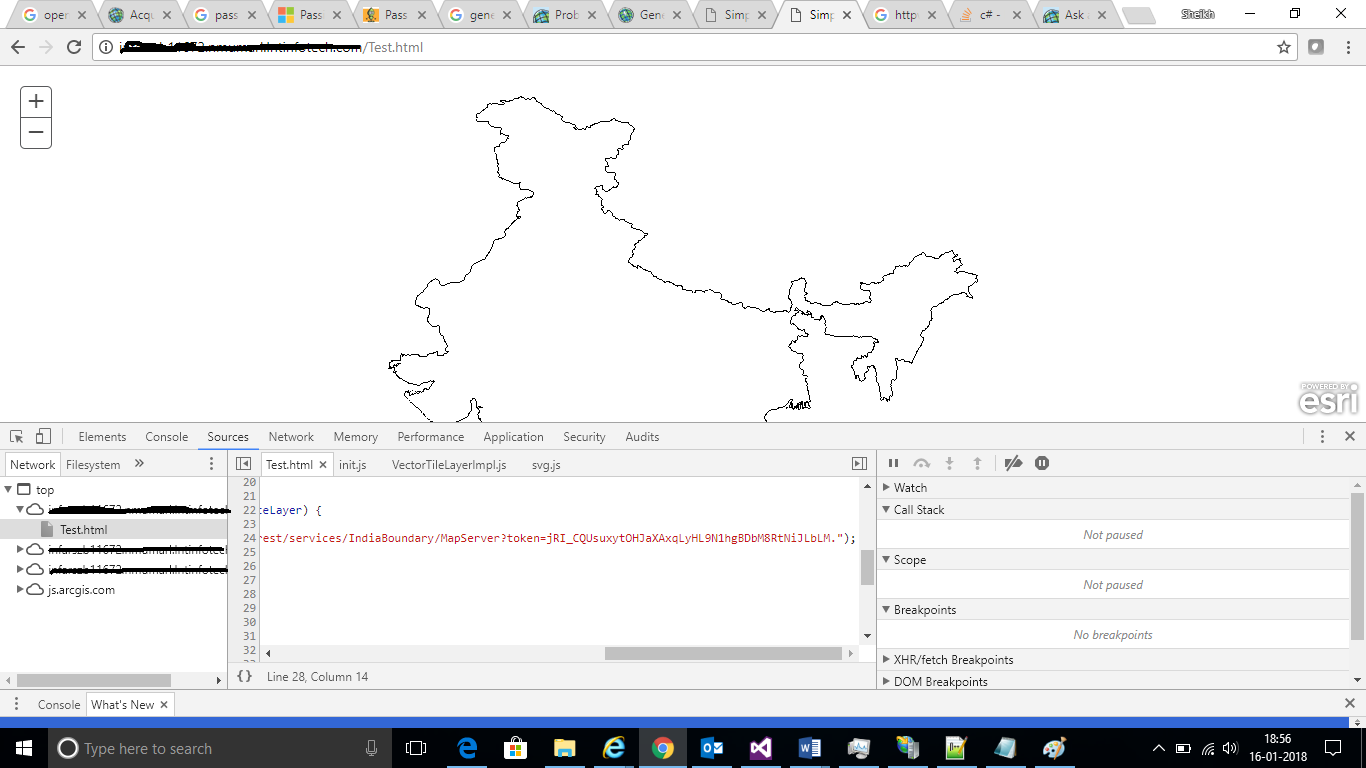

The token generated from the above code is like this : jRI_CQUsuxytOHJaXAxqLyHL9N1hgBDbM8RtNiJLbLM. The above is token is not respecting the above httpreferer URL. If i am adding the above token to the same map service for different site, its working. PFB Image for the same
Correct Referer URL
Test.html
Incorrect Referer URL
Token

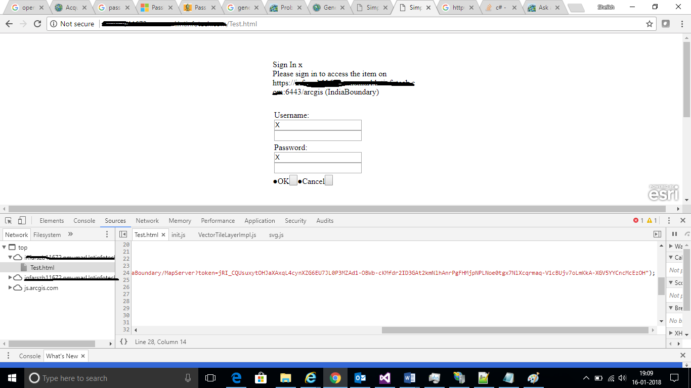

So, I have change the "generateTokenUrl" parameter to https://MachineName:6443/arcgis/admin/generateToken and i got the token as expected (i.e. quite big as above). But it is not working for any application (i.e. neither for the http referer URL nor any other application).A pop-up generated asking for user name & password. PFB Image
Test HTML
How to resolve this?
EvelynHernandez
U need to use the token per each layer u want to add in the map. If u dont do that, it will pop up the login window.
ShaikhRizuan
There is only one layer in the map service.
